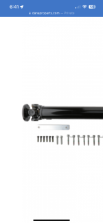

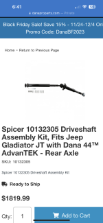

Reminds me of the one Dana spicer made for the JT a few years ago I believe.
